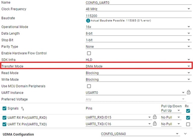

The customer is now evaluating UART of AM2434. On SysConfig, they added 2 channels of UART and chose DMA Mode as Transfer Mode shown as follows.
Compile was succeeded, but the following error occurred at ASSERT (“retVal = Udma_chOpen(drvHandle, rxChHandle, chType, &chPrms” ) when System_init() was executed.
MAIN_Cortex_R5_0_0: ASSERT: 0.3700s: uart/v0/lld/dma/udma/uart_dma_udma.c:UART_udmaInitRxCh:96: UDMA_SOK == retVal failed !!!
Could you give them any advice to solve this issue ?
