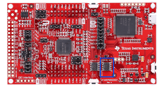

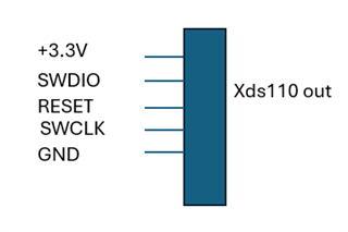

We are trying to build openOCD using the following Repo (https://github.com/nmenon/openocd/tree/mspm0-dev).
We have used MSYS2 to build the openocd.
-- Following dependances we have installed before building openocd
Jimtcl (link)
Libusb-1.0.28
automake
autoconf
pkg-config
libtool
make
Gcc (13.3.0)
Arm GCC (arm-gnu-toolchain-14.2.rel1-x86_64-arm-none-eabi (link))
-- To build OpenOCD we have used the following sequence of command
./bootstrap
./configure --host=i686-w64-mingw32 --enable-ftdi --enable-swd  --disable-werror
 make -j$(nproc)
 make install

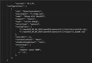

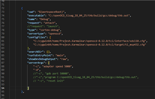

--> launch json file
    "version": "0.2.0",
    "configurations": [
            "name": "MSYS OpenOCD Debug",
            "cwd": "${workspaceRoot}",
            "executable":  "C:/Users/UserName/Downloads/Repos/_Repo/vs_code_integration/thb/build/gcc/debug/temp.out",
            "request": "attach",
            "type": "cortex-debug",
            "servertype": "openocd",

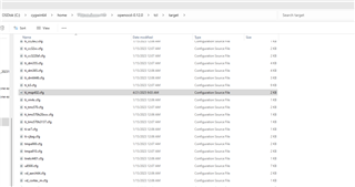

            "configFiles": [
                "C:/openocd_msys/tcl/interface/xds110.cfg",
                "C:/openocd_msys/tcl/target/ti_mspm0.cfg"
            "runToEntryPoint": "main",
            "showDevDebugOutput": "raw",
            "searchDir": [],
            "svdPath": "C:/Users/UserNameDownloads/Repos/Repo/vs_code_integration/utils/MSPM0G350X.svd",
            "svdFile": "C:/Users/UserName/Downloads/Repos/Repo/vs_code_integration/utils/MSPM0G350X.svd"

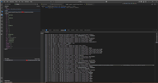

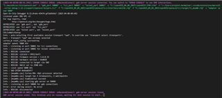

getting the above error. Do you have any suggestions?

    This error is usually indicative that there were errors in the paths provided. I would recommend checking the paths set again to confirm they are correct.
    Try addingthe following launch configuation property:
    "overrideLaunchCommands": [
        "file /full/path/to/my_executable.out"
    Note that my_executable.out is the same file specified under the executable property.
    Here is an example you could refer to as well.

  • Hi, have added correct path, and changes done accordingly.
    --> (launch.json file)
        "configurations": [
                "name": "Debug with TI Embedded Debug for VS Code",
                "cwd": "C:/openOCD_04_04_2025/openOCD/THB/thb/build/gcc/debug",
                "executable": "my_executable.out",
                "request": "launch",
                "gdbTarget": "localhost:50000",
                "showDevDebugOutput": "none",
                "configFiles": [
                    "interface/xds110.cfg",
                    "target/ti_mspm0.cfg"
                "searchDir": [
                    "C:/openOCD_04_04_2025/openOCD/openocd/tcl"
                    "file my_executable.out",
                    "target remote localhost:50000"
                "serverArgs": [
                    "-c", "adapter speed 5000",
                    "-d",
                    "-c", "gdb port 50000",
                    "-c", "tcl port 50001",
                    "-c", "telnet port 50002",
                    "-c","program C:/openOCD_04_04_2025/openOCD/THB/thb/build/gcc/debug/my_executable.out",
                    "-c", "reset init"
    --> (settings.json file)
        "cortex-debug.gdbPath": "C:/arm-gnu-toolchain-13.3.rel1-mingw-w64-i686-arm-none-eabi/arm-gnu-toolchain-13.3.rel1-mingw-w64-i686-arm-none- eabi/bin/arm-none-eabi-gdb.exe",
        "cortex-debug.openocdPath": "C:/msys64/usr/bin/openocd.exe"

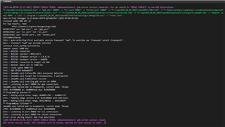

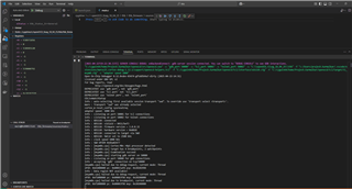

    i have added ("-c","program C:/openOCD_04_04_2025/openOCD/THB/thb/build/gcc/debug/my_executable.out",)
    also enable (-d) debug.
    Debug: 118972 44517 target.c:2563 target_read_u32(): address: 0x400ce3d0, value: 0x00000003
    Debug: 118973 44517 target.c:2651 target_write_u32(): address: 0x400ce104, value: 0x00000001
    Debug: 118974 44518 target.c:2651 target_write_u32(): address: 0x400ce124, value: 0x000001ff
    Debug: 118975 44518 target.c:2651 target_write_u32(): address: 0x400ce120, value: 0x41c00150
    Debug: 118976 44519 target.c:2651 target_write_u32(): address: 0x400ce210, value: 0xfffffffe
    Debug: 118977 44519 target.c:2345 target_write_buffer(): writing buffer of 8 byte at 0x400ce130
    Debug: 118978 44520 target.c:2651 target_write_u32(): address: 0x400ce100, value: 0x00000001
    Debug: 118979 44521 target.c:2563 target_read_u32(): address: 0x400ce3d0, value: 0x00000004
    Debug: 118980 44522 target.c:2563 target_read_u32(): address: 0x400ce3d0, value: 0x00000003
    Debug: 118981 44522 target.c:2651 target_write_u32(): address: 0x400ce210, value: 0x00000001

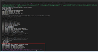

    Debug: 118982 44523 command.c:153 script_debug(): command - echo ** Programming Finished **
    Debug: 118983 44523 log.c:419 gdb_timeout_warning(): keep_alive() was not invoked in the 1000 ms timelimit (44523 ms). This may cause trouble with GDB connections.
    User : 118984 44524 command.c:678 handle_echo(): ** Programming Finished **
    Debug: 118985 44524 command.c:153 script_debug(): command - reset init
    Debug: 118986 44524 target.c:1794 target_call_reset_callbacks(): target reset 3 (init)
    Debug: 118987 44524 command.c:153 script_debug(): command - target names
    Debug: 118988 44524 command.c:153 script_debug(): command - mspm0x.cpu invoke-event reset-start
    Debug: 118989 44525 command.c:153 script_debug(): command - transport select
    Debug: 118990 44525 command.c:153 script_debug(): command - transport select
    Debug: 118991 44525 command.c:153 script_debug(): command - mspm0x.cpu invoke-event examine-start
    Debug: 118992 44525 target.c:4681 target_handle_event(): target: mspm0x.cpu (cortex_m) event: 19 (examine-start) action: _mspm0_enable_low_power_mode
    Debug: 118993 44525 command.c:153 script_debug(): command - mspm0x.dap apreg 4 0x00 0x104008
    Debug: 118994 44525 arm_adi_v5.c:1193 dap_get_ap(): refcount AP#0x4 get 1
    Debug: 118995 44526 arm_adi_v5.c:1218 dap_put_ap(): refcount AP#0x4 put 0
    Debug: 118996 44526 command.c:153 script_debug(): command - mspm0x.dap apreg 4 0xF0 0x01
    Debug: 118997 44526 arm_adi_v5.c:1193 dap_get_ap(): refcount AP#0x4 get 1
    Debug: 118998 44527 arm_adi_v5.c:1218 dap_put_ap(): refcount AP#0x4 put 0
    Debug: 118999 44527 command.c:153 script_debug(): command - mspm0x.dap apreg 4 0x00 0x100008
    Debug: 119000 44527 arm_adi_v5.c:1193 dap_get_ap(): refcount AP#0x4 get 1
    Debug: 119001 44528 arm_adi_v5.c:1218 dap_put_ap(): refcount AP#0x4 put 0
    Debug: 119002 44528 command.c:153 script_debug(): command - mspm0x.cpu arp_examine allow-defer
    Debug: 119003 44529 arm_adi_v5.c:934 mem_ap_init(): MEM_AP CFG: large data 0, long address 0, big-endian 0
    Debug: 119004 44529 command.c:153 script_debug(): command - mspm0x.cpu invoke-event examine-end
    Debug: 119005 44529 command.c:153 script_debug(): command - mspm0x.cpu invoke-event reset-assert-pre
    Debug: 119006 44529 command.c:153 script_debug(): command - transport select
    Debug: 119007 44530 command.c:153 script_debug(): command - mspm0x.cpu arp_reset assert 1
    Debug: 119008 44530 target.c:2131 target_free_all_working_areas_restore(): freeing all working areas
    Debug: 119009 44530 cortex_m.c:1691 cortex_m_assert_reset(): [mspm0x.cpu] target->state: halted, examined
    Debug: 119010 44531 cortex_m.c:1806 cortex_m_assert_reset(): [mspm0x.cpu] Using Cortex-M SYSRESETREQ
    Debug: 119011 44532 arm_adi_v5.c:859 dap_dp_init_or_reconnect(): mspm0x.dap
    Debug: 119012 44532 arm_adi_v5.c:783 dap_dp_init(): mspm0x.dap
    Debug: 119013 44533 arm_adi_v5.c:816 dap_dp_init(): DAP: wait CDBGPWRUPACK
    Debug: 119014 44533 arm_adi_v5.h:682 dap_dp_poll_register(): DAP: poll 4, mask 0x20000000, value 0x20000000
    Debug: 119015 44533 arm_adi_v5.c:824 dap_dp_init(): DAP: wait CSYSPWRUPACK
    Debug: 119016 44534 arm_adi_v5.h:682 dap_dp_poll_register(): DAP: poll 4, mask 0x80000000, value 0x80000000
    Debug: 119017 44534 xds110.c:1333 xds110_swd_queue_cmd(): XDS110: refusing to enable sticky overrun detection
    Debug: 119018 44588 command.c:153 script_debug(): command - mspm0x.cpu invoke-event reset-assert-post
    Debug: 119019 44589 command.c:153 script_debug(): command - mspm0x.cpu invoke-event reset-deassert-pre
    Debug: 119020 44589 command.c:153 script_debug(): command - transport select
    Debug: 119021 44589 command.c:153 script_debug(): command - mspm0x.cpu arp_reset deassert 1
    Debug: 119022 44589 target.c:2131 target_free_all_working_areas_restore(): freeing all working areas
    Debug: 119023 44589 cortex_m.c:1849 cortex_m_deassert_reset(): [mspm0x.cpu] target->state: reset, examined
    Debug: 119024 44590 command.c:153 script_debug(): command - mspm0x.cpu invoke-event reset-deassert-post
    Debug: 119025 44590 command.c:153 script_debug(): command - transport select
    Debug: 119026 44590 command.c:153 script_debug(): command - mspm0x.cpu was_examined
    Debug: 119027 44590 command.c:153 script_debug(): command - mspm0x.cpu arp_waitstate halted 1000
    Debug: 119028 44592 cortex_m.c:1012 cortex_m_poll_one(): [mspm0x.cpu] Exit from reset with dcb_dhcsr 0x30003
    Debug: 119029 44594 cortex_m.c:619 cortex_m_endreset_event(): [mspm0x.cpu] DCB_DEMCR = 0x01000401
    Debug: 119030 44595 target.c:2651 target_write_u32(): address: 0xe0002000, value: 0x00000003
    Debug: 119031 44597 target.c:2563 target_read_u32(): address: 0xe0002000, value: 0x00000041
    Debug: 119032 44597 target.c:2651 target_write_u32(): address: 0xe0002008, value: 0x00000000
    Debug: 119033 44598 target.c:2651 target_write_u32(): address: 0xe000200c, value: 0x00000000
    Debug: 119034 44600 target.c:2651 target_write_u32(): address: 0xe0002010, value: 0x00000000
    Debug: 119035 44601 target.c:2651 target_write_u32(): address: 0xe0002014, value: 0x00000000
    Debug: 119036 44603 target.c:2651 target_write_u32(): address: 0xe0001020, value: 0x00000000
    Debug: 119037 44604 target.c:2651 target_write_u32(): address: 0xe0001024, value: 0x00000000
    Debug: 119038 44605 target.c:2651 target_write_u32(): address: 0xe0001028, value: 0x00000000
    Debug: 119039 44606 target.c:2651 target_write_u32(): address: 0xe0001030, value: 0x00000000
    Debug: 119040 44607 target.c:2651 target_write_u32(): address: 0xe0001034, value: 0x00000000
    Debug: 119041 44608 target.c:2651 target_write_u32(): address: 0xe0001038, value: 0x00000000
    Debug: 119042 44609 cortex_m.c:852 cortex_m_debug_entry(): [mspm0x.cpu]
    Debug: 119043 44611 cortex_m.c:557 cortex_m_clear_halt(): [mspm0x.cpu] NVIC_DFSR 0x9
    Debug: 119044 44614 cortex_m.c:359 cortex_m_fast_read_all_regs(): [mspm0x.cpu] read 20 32-bit registers
    Debug: 119045 44614 cortex_m.c:922 cortex_m_debug_entry(): [mspm0x.cpu] entered debug state in core mode: Thread at PC 0x3ea8, cpu in Non-Secure state, target->state: halted
    Debug: 119046 44614 target.c:1775 target_call_event_callbacks(): target event 0 (gdb-halt) for core mspm0x.cpu
    Debug: 119047 44614 target.c:1775 target_call_event_callbacks(): target event 1 (halted) for core mspm0x.cpu
    User : 119048 44615 armv7m.c:771 armv7m_arch_state(): [mspm0x.cpu] halted due to breakpoint, current mode: Thread
    xPSR: 0xf1000000 pc: 0x00003ea8 msp: 0x20208000
    Debug: 119049 44615 command.c:153 script_debug(): command - mspm0x.cpu curstate
    Debug: 119050 44615 command.c:153 script_debug(): command - transport select

    Debug: 119057 44619 command.c:153 script_debug(): command - init
    Error: 119058 44619 server.c:504 server_loop(): error during select: Bad file descriptor
    [2025-04-09T06:25:00.604Z] SERVER CONSOLE DEBUG: onBackendConnect: gdb-server session closed
    GDB server session ended. This terminal will be reused, waiting for next session to start...
    after this popup comes saying that : (failed to launch GDB:Remote communication error, target disconnected (undocumented error 10061)).
    what might cause this error.?
    when i have removed ("-c","program C:/openOCD_04_04_2025/openOCD/THB/thb/build/gcc/debug/my_executable.out",)
    i am getting in debug as
    [2025-04-09T06:44:30.408Z] SERVER CONSOLE DEBUG: onBackendConnect: gdb-server session connected. You can switch to "DEBUG CONSOLE" to see GDB interactions.
    "C:/msys64/usr/bin/openocd.exe" -c "gdb_port 50000" -c "tcl_port 50001" -c "telnet_port 50002" -s "C:/openOCD_04_04_2025/openOCD/openocd/tcl" -f "c:/Users/prajesh.karmalkar/.vscode/extensions/marus25.cortex-debug-1.12.1/support/openocd-helpers.tcl" -f interface/xds110.cfg -f target/ti_mspm0.cfg -c "adapter speed 5000" -d -c "gdb port 50000" -c "tcl port 50001" -c "telnet port 50002" -c "reset init"
    Open On-Chip Debugger 0.12.0+dev-03474-gf5dd564a7 (2025-04-08-09:48)

    Debug is not working what may the cause.
  • i used arm-gnu-toolchain-13.3.rel1-mingw-w64-i686-arm-none-eabi for to build .out file and for cortex debug gdb path, and for openocd build using gcc(13.3)
  • You're not building it with xds. Add this line  --enable-xds110
  • added --enable-xds110
    --host=x86_64-w64-mingw32 --enable-ftdi --enable-swd --disable-werror  --enable-xds110

    Debug: 125054 45038 command.c:153 script_debug(): command - init
    Error: 125055 45039 server.c:504 server_loop(): error during select: Bad file descriptor
    Debug: 125056 45039 breakpoints.c:328 breakpoint_remove_all_internal(): [mspm0x.cpu] Delete all breakpoints
    Debug: 125057 45039 arm_adi_v5.c:1218 dap_put_ap(): refcount AP#0x0 put 0
    Debug: 125058 45039 target.c:2131 target_free_all_working_areas_restore(): freeing all working areas
    Debug: 125059 45039 xds110.c:1118 xds110_swd_switch_seq(): SWD-to-JTAG
    Info : 125060 45142 xds110.c:451 usb_disconnect(): XDS110: disconnected
    [2025-04-09T15:32:47.046Z] SERVER CONSOLE DEBUG: onBackendConnect: gdb-server session closed

    and below is my launch json file .
        "configurations": [
                "cwd": "C:/openOCD_09_04_2025/THB/thb/build/gcc/debug",
                "executable": "thb.out",
                "configFiles": [
                "searchDir": [
                    "C:/openOCD_09_04_2025/openocd/openocd/tcl"
                    "file thb.out",
                "serverArgs": [
                    "-d",
                    "-c","program C:/openOCD_09_04_2025/THB/thb/build/gcc/debug/thb.out",
                    "-c", "reset init"
    Error:
    target still getting disconnecting,

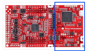

    Currently i am using Mspm0g3507 launch pad debugger section to communicate with target (i.e Target is my project board. Having MSPM0G3507 controller)
    If possible, can you share me the openocd build steps and launch json and settings files , using which programing and debugging works from your end?
    You said you use debugger in the launchpad for debugging your self application board. Which pins are you using for connecting?
  • Hi Xie
    I am using xdx110 out connector
    CONNECTOR PINS

    The debug session is not starting from the main.c, it says file not found. Any suggestions on this?
    With the disabling of the debug flag
    [2025-04-21T06:56:36.452Z] SERVER CONSOLE DEBUG: onBackendConnect: gdb-server session connected. You can switch to "DEBUG CONSOLE" to see GDB interactions.
    "C:/cygwin64/home/Prajesh.Karmalkar/openocd-0.12.0/src/openocd.exe" -c "gdb_port 50000" -c "tcl_port 50001" -c "telnet_port 50002" -s "C:\\openOCD_tisag_18_04_25\\thb" -f "c:/Users/prajesh.karmalkar/.vscode/extensions/marus25.cortex-debug-1.12.1/support/openocd-helpers.tcl" -f "C:/cygwin64/home/Prajesh.Karmalkar/openocd-0.12.0/tcl/interface/xds110.cfg" -f "C:/cygwin64/home/Prajesh.Karmalkar/openocd-0.12.0/tcl/target/ti_msp432.cfg" -c "adapter speed 5000"
    Licensed under GNU GPL v2
    For bug reports, read
    openocd.org/.../bugs.html
    CDLiveWatchSetup
    Info : auto-selecting first available session transport "swd". To override use 'transport select <transport>'.
    cortex_m reset_config sysresetreq
    adapter speed: 5000 kHz
    Info : Listening on port 50001 for tcl connections
    Info : Listening on port 50002 for telnet connections
    Info : XDS110: connected
    Info : XDS110: vid/pid = 0451/bef3
    Info : XDS110: firmware version = 3.0.0.32
    Info : XDS110: hardware version = 0x0028
    Info : XDS110: connected to target via SWD
    Info : XDS110: SWCLK set to 2500 kHz
    Info : clock speed 5000 kHz
    Info : SWD DPIDR 0x6ba02477
    Info : [msp432.cpu] Cortex-M0+ r0p1 processor detected
    Info : [msp432.cpu] target has 4 breakpoints, 2 watchpoints
    Info : starting gdb server for msp432.cpu on 50000
    Info : Listening on port 50000 for gdb connections
    Info : accepting 'gdb' connection on tcp/50000
    undefined debug reason 8 - target needs reset
    [msp432.cpu] halted due to debug-request, current mode: Thread
    xPSR: 0xf1000000 pc: 0x00003f98 msp: 0x20208000
    The example provided by Pengfei above shows how it can be done for MSP432, the same method can be applied to MSPM0 as well. Please switch the configuration to use MSPM0 instead of MSP432 as you are using it for the MSPM0 device.
  • Hi
    Yes, But there is no configuration file related to mspm0 in the openocd target folder, as shown below. What to do in this case ?
  • Please clone the master branch of the project. You are not on the master branch.
    The example provided by Pengfei showed the steps on how to compile it but it points to a different version of the OpenOCD project.
    These are the steps you will need to follow.
    1) Clone the master branch of the OpenOCD project
    2) Build using the steps provided
  • Hi Henry, As per your suggestion, i have done the above steps. but
    debug session not able to find main.c file as shown above image.
