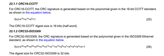

Do you have sample code CRC8H27 with polynomial 0x2F used for TLIN1431device ?
Daria
Hi Daria,
MSPM0 support CRC16-CCITT and CRC32- ISO3309 polynomial functions, please see Chapter 22 CRC of MSPM0 G-Series 80-MHz Microcontrollers Technical Reference Manual (Rev. B) for more details.
Which CRC algorithm is customer desiring for ?
