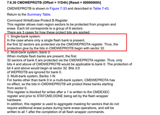

First I'm erasing the sector where I'm intended to write. So after erase that sector area which it belongs to will be locked(according to datasheet) but I'm locking all the regions explicitly by giving maximum to PROT A,B,C. My interest is only Main flash area no bootloader nothing.
FLASHCTL->GEN.CMDWEPROTA = FLASHCTL_CMDWEPROTA_VAL_MASK | FLASHCTL_CMDWEPROTA_VAL_MAXIMUM;
    FLASHCTL->GEN.CMDWEPROTB = FLASHCTL_CMDWEPROTB_VAL_MASK | FLASHCTL_CMDWEPROTB_VAL_MAXIMUM;
    FLASHCTL->GEN.CMDWEPROTC = FLASHCTL_CMDWEPROTC_VAL_MASK | FLASHCTL_CMDWEPROTC_VAL_MAXIMUM;
Then I'm blank verifying the region if it's true then I'm trying to write some data in this write api when I'm check if the flash is locked or not then I'm getting it as false
return ((FLASHCTL->GEN.CMDWEPROTA == FLASHCTL_CMDWEPROTA_VAL_MAXIMUM)
            && (FLASHCTL->GEN.CMDWEPROTB == FLASHCTL_CMDWEPROTB_VAL_MAXIMUM)
            && (FLASHCTL->GEN.CMDWEPROTC == FLASHCTL_CMDWEPROTC_VAL_MAXIMUM));
 Why lock is not happening.
