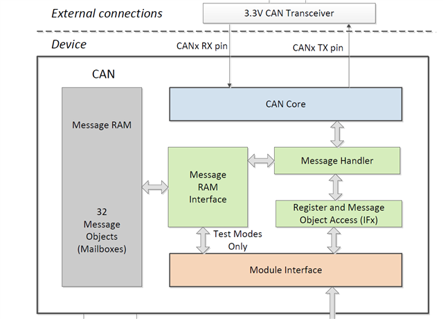

Hi experts,
I ask this for my customer.
In 2800157 TRM, it shows it have 32 message object in one CAN module,
But I can't find this in am2634, could you help to answer this?
BRs
Shuqing
I think you may need the Bosch MCAN manual: https://www.bosch-semiconductors.com/media/ip_modules/pdf_2/m_can/mcan_users_manual_v331.pdf
Hello Shuqing,
I am including a screenshot of the TRM below for reference.
As stated the module is configured to allocate 4352 32-bit words.
There 64 elements available for RX FIFO[0:1] and the RX Buffer and 32 elements for TX Event FIFO and the TX Buffer.
