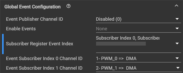

  • Thanks for your information, Pengfei.
    I have some more questions.
    Then, what if the TIMx publish the event for getting the duty value every cycle for 7ch PWMs, and the cc value is subscribed from DMA,
    could whole 7ch PWMs can subscribe the DMA buffer?
       - As I configure the event that PWM0~6 as publisher and DMA as subscriber in CCS, the DMA (subscriber) could only be allocated for one PWM channel (publisher).
       - I am quite confused about which one should be the publisher and which one should be the subscriber, and wondered it actually be implemented for control 7ch PWMs by one DMA with generic event.
    And also, I'm curious about the DMA channels. If the compare value for each 7ch PWMs are different, could I designate each value using DMA channels in specific address?
    Thanks for your help in advance.
    Yesol

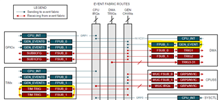

  • Hi Yesol,
    Let me clarify that the EVENT in MSPM0 is used to transfer from an trigger event to an pre-defined action.
    For example, if you use DMA as event publisher, the trigger event could be DMA transfer finished. And if the Timer is event subscriber, its re-defined action could be ZERO (load zero to the counter), LOAD (load LOAD value to the counter), or CC (load counter value to CC register). But I assume this is not you want.
    I think you could set a timer event as publisher (for example, PWM counter ZERO event), and set DMA as subscriber, so DMA transfer will be triggered each PWM period. The DMA source address is the buffer you set, and the destination address could be CC register of each PWM channel (Not test for this case, but CC register address could be found in TRM). You should set source and destination address for each DMA channel and each DMA channel is for a PWM channel.
  • Hi Pengfei,
    Thank you for the explanation.
    Now I wonder that if FSUB_x can be shared with 7ch PWMs' publisher.
    As I described, we should trigger the event for 7ch PWMs, but DMA seems only have two subscribers (FSUB_0, FSUB_1) to trigger for 7 channels of DMA.
    and when I'm configuring in CCS, I can only set for two index channel ID, even for global event configuration not for per channels.
    I think it seems impossible to make the event for 7ch PWMs with DMA channels.
    Please feel free to correct me If I've misunderstood anything.
    Many thanks

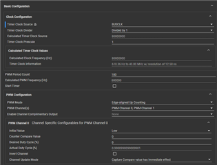

  • Hi Pengfei,
    I configured the timer clock below, I will use 80MHz clock source to make 800kHz as PWM Freq with 100 period count.
    So, it takes 1.6us delay with 80MHz based on your explanation.
    But I wonder it really takes that much time for DMA? that means it needs 128cycles to transfer for one data.
    Could you please double check it takes 1.6us to transfer 16bit data per channel of DMA when we use 80MHz clock source?
  • Hi Yesol,
    I estimate the DMA transfer time based on the assumption of DMA transfer 1bit for 1 cycle.
    But actually for a 32bit data bus, it should could transfer 32bit data a time within several cycles.
    So the actual time may be less than 1.6us in 80MHz, you could test with below steps:
    1. Using DMA cascading channel function.
    2. Toggle a GPIO when the first DMA trigger is generated.
    3. Toggle the GPIO again when the last DMA channel is finished.
    4. Observe the GPIO pulse time to derive delay.

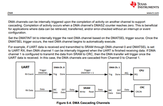

  • Hi Yesol,
    Sorry for late reply.
    #1 As for DMA cascading channel, it means one DMA channel (such as ch1)  could be triggered by another DMA channel transfer done event (such as ch0 done), please refer the below diagram.
    As for the configuration, the cascading channel could be achieved by setting CH0 trigger type as external DMA channel (FSUB_0), and setting CH1 trigger type as internal DMA channel and select DMA channel 0 as trigger source. And the same configuration could be done for ch2~ch15.
