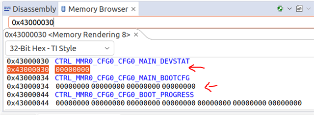

Hi there,
I am debugging issues with two am2434 in daisy chain, sitara-1 and sitara-2. I am interested in satara-2 in the daisy chain. CCS scripting
The first setup usings two TI AM243-LP. I can perform ccs scripting successfully. I also see the console outputs that mostly matches TI documentation about CCS Scripting of AM243-LP.
After that I can download other application and get it executed.
The second setup uses two sitara chips on our own boards in daisy chain. With the same scripts, I cannot perform ccs scripting.
Right now I run out of hypotheses. Therefore I want to check bootmode register, with which I can check if there is error in hardware.
How to read out the value of CTRLMMR_MAIN_DEVSTAT?
Jinlong
Reading memory at two proxy addresses. The values are zero.
