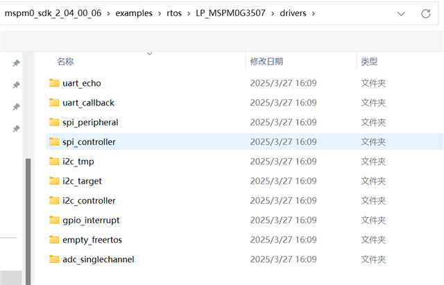

Hi team - We trying to figure out what the flash size for some of the TI drivers in a FreeRTOS environment would be. I am currently searching online but I haven’t been able to find anything yet.
Do you have any information about the total flash sizes of each of these TI drivers for the MSPM0G family: ADC, SPI, GPIO, TIMER, Watchdog?
From what I have read about these devices, it sounds like there aren’t special drivers that are used with FreeRTOS but rather a DPL is used to integrate the TI drivers with FreeRTOS. Is this accurate?
Jacob
  • Hi Jacob,
    Below picture shows the freertos examples we have in our current SDK.
    For each example, its flash size allocation could be found in CCS "View -- Memory Allocation", you could take a simplify evaluation based on these examples:
