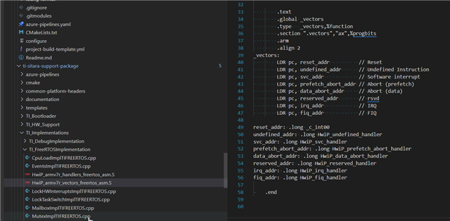

This worked pretty fine all the time. SO in general we did overwrite the abort-handlers with our own implementation. This worked by providing the implementation AND the sdk-files (copied) additionally in our application-build. When linking the sdk, in this case the freertos-library of the sdk, our abort-handlers were used. The thing is that our implementation will call c++-code and thus is placed inside a .cpp-file (surrounded with extern "C").

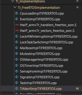

It looks like this in the sdk:
and like this in our folder:
where the "TIAbortImplTIFREERTOS.cpp" contains the copied code of the HwiP_armv7r_handlers_freertos.c-file. (with the extern "C" around and calls to C++-code).
