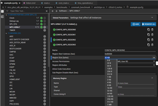

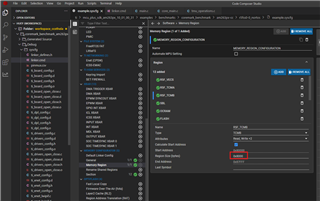

1. In TRM, TCMB_RAM start address and size for R5FSS0-1, 1-0, 1-1 seem incorrect. Should they end at 0x0009_FFFF and have a size of 96KB?
2. In sdk examples, most (if not all) sysconfig files set TCMB to be 32KB. Should it not be 96KB as well?
coremark_benchmark:
3. Should MPU be configured to set 2 regions (32KB + 64KB)? Since it only allows powers of 2. 96KB is not an option.
