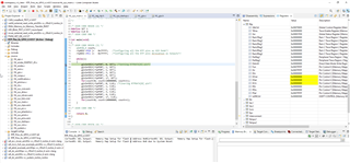

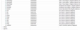

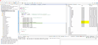

I'm tring to use GIO as output from RTP (RAM Trace port), and not able to toggle or set/ clear any pin. These pins are available over Hercules Development port. If I configure it as input it's working but they are not working output. Aother modules like SCI I have tried but this RTP I'm not able to use. And other question HALCoGen doesn't generate any HL_rtp.c file correct? I can able to find HL_rtp.h only.
