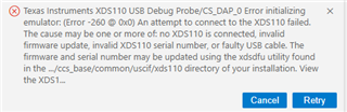

Multiple purchased LaunchPad Boards (3x MSPM0L1306) - do not enumerate via USB.  They do not show up in Windows Device Manager.  I have updated both CCS and drivers (to what appear to be the latest), checked the Micro-B to A cable and attempted the "Recovering a Bricked XDS110 without JTAG" procedure found in XDS110SupportReadMe.pdf to no avail.
The boards do power up (Red flashing and steady green LEDs) and appear functional with the exception of no USB enumeration - not even an "unknown USB device" appears when plugging into the laptop USB port.

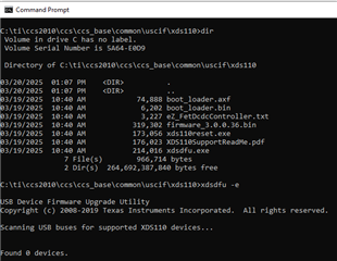

When trying the recovery approach (GroundingTDO pin) - the Red led continues to flash (however the green LED remains off) after attaching the USB cable.  Still the device does not enumerate, and the xdsdfu utility reports No device found.
For some reason - I have posted this question multiple times however it does not appear in either the Forum or E2E threads under My Current Activity.
Assistance would be greatly appreciated as our team cannot proceed until these boards are functional.
