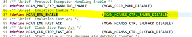

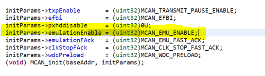

    Issue is resolved after enabling the MCANSS_CTRL.DBGSUSP_FREE. We have made the required change in static file (Can_Mcan.c)
    In the Can_mcanInit function of the Can_Mcan.c file, the code is enabling initParams->emulationEnable.
    However, the macro definition for MCAN_EMU_ENABLE is MCAN_MCANSS_CTRL_EMUEN_DISABLE.
    Therefore, the value of the bit MCANSS_CTRL.DBGSUSP_FREE remains zero.
    I changed the macro definition to MCAN_MCANSS_CTRL_EMUEN_ENABLE and then tested the code with a break command. The issue is no longer present.
