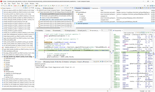

We have to evaluate secure boot features with AM261 LP. However, i have tried out the SBL OSPI example which loads HSMRt firmware. HSMRt firmware download happens but doesnt boot up indicated in the screen shot below:
The loadHSMResult shows the following:
Can you please confirm if the SDK example works from your side?
