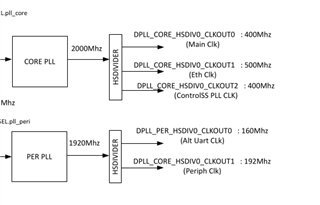

Hi, I've been reading the AM263x TRM revision H section 6.4 on Clocking. I've noticed the following inconsistencies. Please correct me if I have made the wrong assumptions:
Figure 6-22:
Two different signals are labelled "DPL_CORE_HSDIV0_CLKOUT1". I assume the 192MHz instance should be labeled DPLL_PER_HSDIV0_CLKOUT1?
AM263 TRM RevH. Figure 6-22

  • Hello Andy,
    Apologies for the late response here. I've verified that all the inconsistencies pointed out are valid. I've raised an internal bug to fix these in the next revision. Thanks for bringing them to our attention.
    Yes, that is right.
