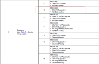

    2. I also have one more doubt regarding which revision of AM2634 supports this functionality required (independent MAC port control or 2h-MII mode). We are having revision D die (for your information).
    S Srinivas.

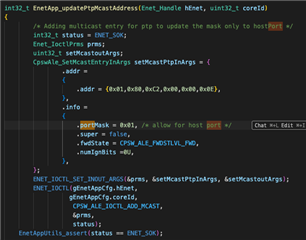

  • Thanks for the clarification susan, can I get the clarification on transmission as well, i.e., if I fill a frame in CPDMA, then the frame will be transmitted to both ports right?
    Also as per your answer in previous thread, you are actually suggesting using mac filter based on the port, right?
    Hi TEMC,
    It is possible and it is configured through the portmask attribute of cpdma pkt descriptor.
    You can look at mcu_plus_sdk/source/networking/enet/core/examples/enet_layer2_multi_channel example which does the same.
