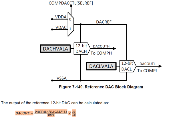

would like to double confirm if the DACOUT calculation formula is correct or not in TRM CMPSS chapter. If it is correct, how to understand the meaning for parameter in the formula?

I would like confirm if below formulae is correct? what is the meaning for parameter 33 x 33 / 18

The internal analog design of the DAC feedback network sets the closed loop gain to 33/18, allowing utilization of the 1.8V DACREF to a full-scale 0V to 3.3V output for DACVALA codes of 0 to 4096.
However, there does seem to be an additional factor of 33 included in the TRM calculation.
I have filed a ticket to have this corrected to the following:
DACOUT = ((DACVALA*DACVREF)/4096) * 33/18
