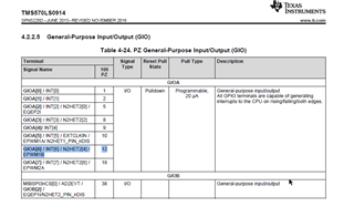

I am using the TMS570ls0914PZ. Previously, it was TMS570ls0432 which has almost the same pin mapping. I have several chip on SPI2. The one linked to SPI2nCS[0] is working well. I expect to have the SPI2nCS[1] on the pin 12 but I am not sure. In the datasheet and Halcogen, SPI2nCS[1] t is mentioned but I don't find where is the pin and where to configure the pin to use it as SPI2nCS[1] .

    I could only see one chip select for SPI2; you can see below screenshot from datasheet of TMS570LS0914.
    And also, for pin 12 there is no SPI functionality. This pin has only GIOA[6], INT[6], N2HET2[4] and EPWM1B functionalities.
    So, i don't think we can implement SPI2nCS[1] in this device.
    I think HALCoGen have a mistake, they added CS[1] here for SPI2 however datasheet never mentioned or never gave pin for CS[1], so there should not be CS[1] for SPI2

    There is just a mention here in the datasheet where it is written SPI2nCS[1:0]:
    I will use GIOA_6 to do the job of CS.
