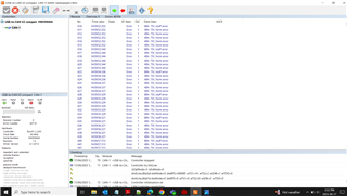

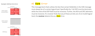

    I am now able to see send and receive messages on my terminal and the communication seems fine. Although, upon checking on CAN Analyzer, I see something called as "Form Error". Could you please help me resolve it?
  • I am now able to see send and receive messages on my terminal and the communication seems fine.
    HI,
      Glad that you have the CAN somewhat working. Can you first tell me what did you do to get it working? Was it a software issue or a transceiver connection issue as I suspected?
    What is the error that you receive on the MCU CAN receiver module. You can look at the CANSTS and CANERR registers. Refer to below Form Error description.
