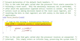

    What I suspect is that the interrupt vector, have you set the SCB->VTOR to 0x2000?

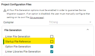

  • Hi Sal Ye, I finally resolved the issue. I didn't disable the automatic file generation of "Startup File Reference" in my project's .syscfg file. So the compiler took the auto generated startup file.
    Thefore, I un-checked it first
    and copied the startup file (startup_mspm0g150x_ticlang.c) from SDK directory.
    Finally, I have set the SCB->VTOR in this startup file and it worked.
