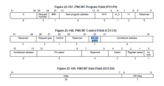

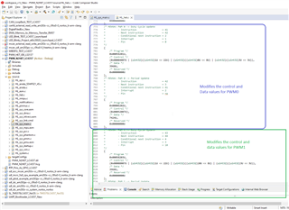

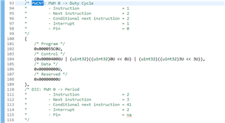

  • Hi Berat,
    Actually, from instruction 41 onwards there will be a MOV64 instructions which will be helpful to modify the control and data values of the PWM's.
    There will be two instructions for every PWM, one for duty cycle updation and other one is for period updation.
    If we see the remote instruction value for instruction-41 it is 1, and similarly for instruction-43 it is 3 etc.
    So that means the values that we are upating into this MOV64 instructions will actually modifies the instructions in remote locations. This is using for smooth updation of the duty and period values, i mean kind of double buffering.
    For example if we are calling the below API for pwm0 means that we are indirectly activating 22nd bit in the instruction-1.
    That means we are setting 22nd bit in the control field of PWCNT instruction.
    Which is "Enable pin action".
    By default, this pin value is zero that means pin action is in disabled state. That means even though counters are running there won't be any pin action that means we can't see any PWM signal on the output pin. So, when we call this "pwmStart" API for corresponding PWM then it is enabling pin action to generate actual PWM on the pin.
