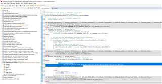

  • Hi Jagadish,
    I downloaded and added API to my project. But I could not trigger  Efuse error that is Group1.40. So according code pieces about efuse on your screenshot " 0==(sl_esmREG->SR4[0] &(GET_ESM_BIT_NUM(ESM_G1ERR_EFUSE_ERR_OTHER)|GET_ESM_BIT_NUM(ESM_G1ERR_EFUSE_SELTEST_ERR)))) " shows that Efuse not triggered. Because sl_esmREG->SR4[0] bits of 8 and 9 are controlled and expected 0. It means ESM error not generated.

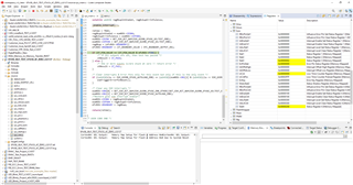

  • Hi Samet,
    I created example project and it is working fine for me:
    As you can see i got both Efuse errors that is ESM1.40 and ESM3.1 and ESM1.41 errors like as shown above.
    Please try to test with below project once:
    EFUSE_SELF_TEST_STUCK_AT_ZERO_LS3137.zip
    Thanks & regards,
    Jagadish.

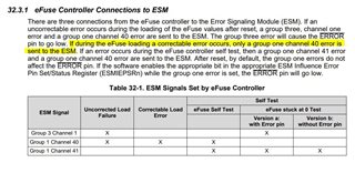

  • Hi Jagadish,
    I already generated the errors that you generated.  Stat4= 0x200 means group 1.41 and Stat3 = 0x2 means group3.1. I am trying to generate only group 1 channel 40. I need to get Stat4= 0x100 that means group 1.40. I am shared below what I want in the reference manual.
  • Hi Samet,
    I didn't see any negative test case to trigger group 1.40, i could only see the positive test case related to it.
    As you can ee if we perform efuse ECC logic self-test procedure that i shared in above pic, this procedure should not create any group 1.40 or group 1.41 as we didn't get any error bit in the ESM error status register bits 4 to 0.
    If there is any error, then this test case should trigger both 1.40 and 1.41 like as highlighted in below table. As in our case there is no errors, so it didn't trigger any of them.
    So, i think we can only do the positive side of testing for 1.40 instead of negative testing.
    Thanks & regards,
    Jagadish.
