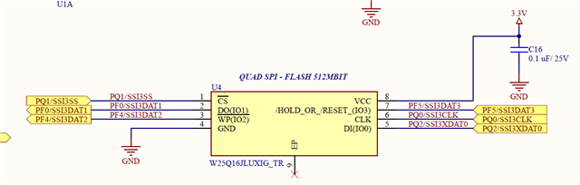

We are interfacing W25Q16JLUXIG_TR  16MB flash but not able to read device ID. Also not able to write to flash.
I am attaching the file for reference

Its 16MB but schemtic it is wrong show 512MB

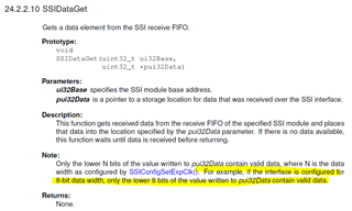

      Do you have a scope cap or logic analyzer waveform for the SSI3 interface? Do the signals conform to the timing requirement for W25Q16JLUXIG_TR for reading the manufacture and device ID? Reading the W25Q16JLUXIG_TR datasheet, you need to use the serial (1-bit) mode, not quad mode. See below. You would need to send a 90h instruction followed by 24 bits of 0 and after which you can read out the manufacture ID (EFh) and the Device ID. In your code snippet for SSILibSendReadIDAdvMode, what is stored in g_ui8InstrReadID[]? Please check if g_ui8InstrReadID contains the 90h and three bytes of 0. Below is the sequence I expect:
     - Hold the CS/Frame signal low using SSIAdvFrameHoldEnable.
    - SSIAdvModeSet(ui32Base, SSI_ADV_MODE_READ_WRITE);
      - Call SSIDataPut() to send out 90h and five bytes of 0. The last two bytes are don't care but you need these two dummy bytes to create clocks to the slave for the manufacture ID and Device ID to return.
      - Call SSIDataGet to read the data from the RX FIFO. You need to mask out the upper bits. See SSIDataGet user's guide.
