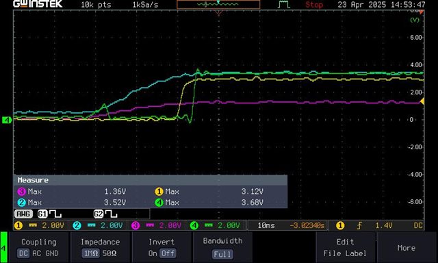

  • Yes, all the SOP pin are confirm by DSO probe only, and i already shared current status of all the required pins to boot up the mcu
    power up sequece
    3.3v - channel-2 blue
    1.2v - channel-3 pink
    PORz - channel-1 yellow
    WARMRST - channel-4 green
    25 MHz crystal oscillator is connected in our board instead of TCXO,
    is it fine to get 'C' in UART mode or  TCXO required only
