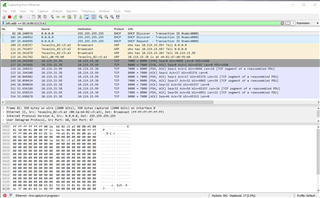

     I am working on TCP, am using lwip_tcp_echo_client_lwip.c example code, but unable to see tcp communication on wireshark app. Can you guide how ro resolve this. Server ip: my pc ipv4(changed in code) other than this anything has to change in code.

      Can you show the wireshark capture?

      You should see an example wireshark capture like below. In my capture, the server is 10.219.15.38 and the client IP is 10.219.15.99. The client will send a SYN to the server and the server will reply with a SYN, ACK. Do you see this on your capture?
      The example is hardcoded with a server IP address using #define SERVER_IPADDR. Did you change this to your own server IP address?
