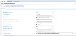

Hello Team,
I want use debug free stop functionality, like "The peripheral freezes functionality while the Core Halted input is asserted and resumes when its deasserted."
I am able to control it manually by setting this particular register.
But I didnt found any configuration option in MCAL(EB Tresos configurator).  Could you please guide us on this?
  • Hi Rohidas,
    As I know, not all the functions descripted in our TRM is integrated in MSPM0 MCAL currently, if corresponding feature is not specified in AutoSAR standard.
    Is this critical for your FW development? I think it may be debug related, and maybe you could set it by register when debugging and just remove it for your production program.
