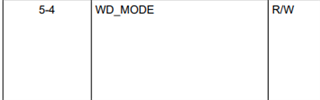

In wdg.h the wd_mode mask is 0x10 when it should be 0x30. This causes the function Pmic_wdgSetCfg to not set the PMIC into QA mode correctly. I am using version 10.01.00.31 of the SDK.
Please fix in future sdk releases.
Hello Theo,
Thanks for reporting this, we will file a bug to have this resolved for future releases.
