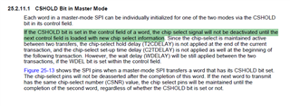

  • Hi Jagadish,
    Thank you for your prompt reply. The method that you proposed above was the first method that came to my mind. However, we might have to start the communication directly via DMA transfers, from the MCU RAM to the MibSPI5 TXRAM, so it won't be practical to enable a GPIO before the transfers, unless there are tweaks that we can do to overcome that ...
    About the "CS0 inverter" method in my question, since the SPI5 will be dedicated to 2 slave devices, what could be dangerous if one being always listening to the SPI bus, and if there is no data on the line? Potential noise issues?
    Chuck.
    I mean for some slave devices we might need to toggle the chip-select in between frames as well, for those devices we might face some issues, if you don't have this requirement then it's okay.
    And also, you maybe need to use different CSNR value for both the devices
    You need to consider changing of CSNR value also in the both the devices data input. If you use same CSNR value, then again you might always communicate with one device only.
    Also use the CSHOLD bit to hold the CS line in between the transfers, otherwise CS will activate other device in between the transfers.
    I think these are the things we might need to care about and apart from this i don't find any issues. My suggestion would be better to create one prototype based on your requirements and if everything working fine then you can go for production.
