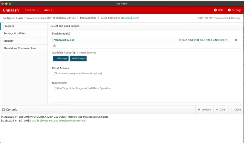

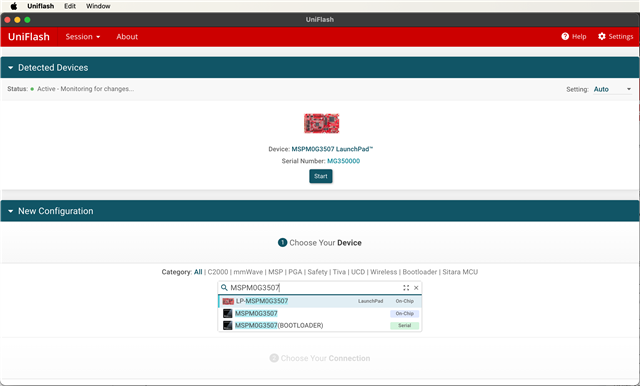

  • Barry,
    I can see the same on my mac.  It looks like the bootloader (serial) configuration has a dependency that does not ship with UniFlash.
    I am able to use the the default connection that uses the embedded XDS110 debug probe fine.
    I.e. if I let it detect my board and use the default connection at the top that is fine.  Or in the new configuration section I can use either of the top 2 options just not the BOOTLOADER one.
    I will file an issue to track this.  Likely just a packaging issue.
