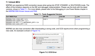

    As for MSPM0 series, when it report the DAP connection error, there always related the SWD signal issues:
    1. The connection is error
    2. The MCU encounter some fault status (normally with a wrong firmware, and MCU run out of control)
    3. There occurs reset to MCU (external NRST, WWDT, software reset in code, etc). The reset behavior will break the SWD connections, which might cause the DAP error issues.
    4. NONMAIN area broken due to incorrect operation.
    Hope this will be helpful for your reference.
    For the #2, this might be high frequently happen to user side, we can connect PA18 (BSL invoke pin) to VCC, then it will run into ROM BSL, not to application code, and then it could reconnect again.
    Others method to unlock device, you can refer to below chapter:
    https://www.ti.com/lit/ug/slaaed1e/slaaed1e.pdf?ts=1745919400787
