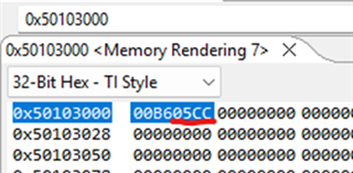

I want to implement overcurrent detection for a motor controller. I connected the analog output of my control circuit to the ADC3_AIN2 pin of the AM263P-LP. The value I read from this channel, as seen in the image, is 0x5CC.
I am using CMPSSA7. I verified in the reference manual that this CMPSS module is connected to the relevant ADC channel.
I also shared the values of DACH and DACL in the screenshot.
Despite all of this, I observe a high comparator trip, and COMPHSTS is being set.
I have also included screenshots of the CMPSSA7 configuration.
What am I doing wrong?
Burak
    • I configured the negative input (IN−) of the high comparator to external pin INL (instead of internal DAC). This is physically mapped to ADC3_AIN3.
    • When I apply a signal to INH and a known reference to INL , the comparison logic works perfectly and the COMPHSTS bit is set as expected.
    • When I switch the negative input source from external pin INL to the internal DAC, the comparator doesn’t behave correctly.
  • When I set the negative input source to the internal DAC,
    Here is the behavior I'm observing :
    • When I apply 0V to the corresponding ADC pin:
      • COMPLSTS → 1
      • COMPHSTS → toggles between 0 and 1
    • In other voltage conditions:
      • COMPLSTS → 0
      • COMPHSTS → 1
