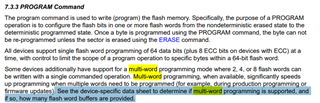

3. It is written on TRM that to see the device-specific data sheet to determine if multi-word programming is supported or not.
But customer and i could not find anywhere on data sheet. Could you let me know where is it ?

    (2) in Multi-Word Programming, is it correct to think that the number of writes per command execution is a count of one time?
    Currently we only support single word programming in M0G3107.
     - If not showed in datasheet, you can treat it as not support.
    Will feedback to team and consider to add additional description in datasheet. In case there any confusion.

  • Hi Sal,
    Noted. Thank you.
    If M0 device does not support this, why it is written on TRM.. ?
    We need to explain it to customer.
    Kenley
  • Hi Kenley,
    I have reported to team and we will dicuss how to add notes to avoid confusion.
