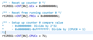

    Part of the rtiInit function is as follows:
    The waveform of the call to delayus(5) is shown below:
    The procedure is shown below.

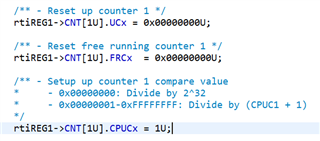

  • Hi Gundavarapu
    As shown below, I set the clock frequency to 50MHz.
    CPUCx set to 1
    Use the overflow interrupt flag bit of counter 0 in main.
    The measured waveform is 2.6MHz.
    This should be considered a minimum interval interrupt, right?
  • Hi Sam,
    Apologies for the delayed response,
    Yes, this should be considered as minimum interval.
    Please consider from Pulse width only not entire period because you are toggling the bit after every timeout.
    So, in your case the minimum width is 378/2 = 189ns.
