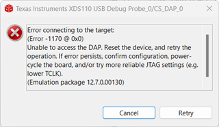

TM4C123GH6PM: Unable to access the DAP after reset.
Part Number: TM4C123GH6PM
Other Parts Discussed in Thread: EK-TM4C1294XL

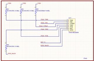

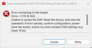

I am having trouble programming a TM4C123GH6PM on a custom board. I keep getting the following error message,
I have tried resetting the DAP using dbgjtag.exe but this has not worked.

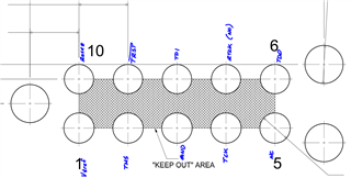

Below is a screenshot of the JTAG header,
Channel 1 TMS, Channel 2 TCK, Channel 3 TDI, Channel 4 TDO.

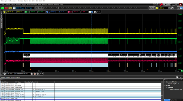

Data from a protocol decode is attached.
AllanDAP.csv

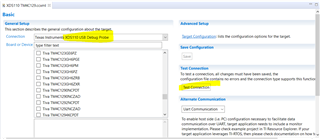

  • Hi Allan,
      Can you run a JTAG scan chain test? See below in CCS. What does the result show?
      Do you have another debug probe? Can you repeat the same issue with another probe? I want to know if this is a debug probe issue or a board issue.
      I suppose this is your custom board, correct? How many boards do you have that show the JTAG connection issue? I want to know if this is a one-off issue.
      Looks like you have already tried the "Unlock" operation and still does not recover the device. The Unlock operation will not help if it is a virgin device.  The Unlock operation can work for the below situations:
      - You have put the device into deepsleep or hibernate mode without a mechanism to wake up. Without a running clock, the debug probe cannot synchronize with the processor.
      - Your application repurposes the JTAG pins for GPIO.
      - You have programmed the BOOTCFG register to disable JTAG interface.
      If none of the above has happened to you then the Unlock will not work.
      Please also refer to this app note https://www.ti.com/lit/pdf/spma075 on section 6 on how to debug JTAG issues. Section 4 has various example schematics for JTAG header. Compare with your implementation and see if you find any difference.
    Yes please see below.
    The first board JTAG scan chain using the XDS110 test is successful.

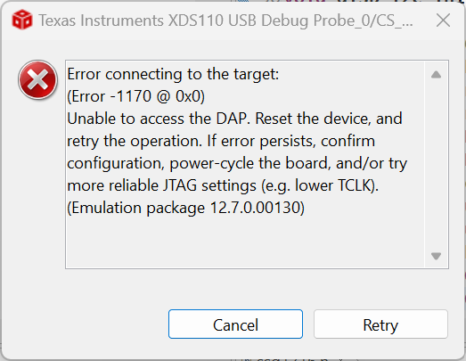

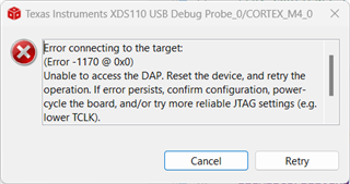

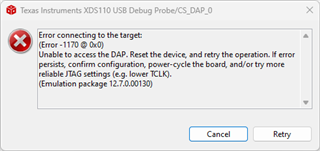

    When trying to debug I am still getting that unable to access DAP error message.

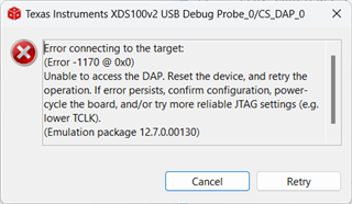

    Switching to a XDS100V2 debug probe does still pass the JTAG scan test.

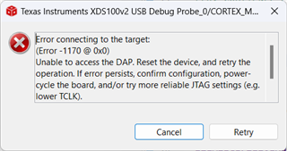

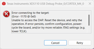

    I am still unable to debug with the XDS100V2.
    Trying a second board with the XDS110 passes the JTAG scan chain test,

    I am still unable to debug with the XDS110 on the second board.
    Switching to the XDS100V2 on the second board passes the scan test,
    Second Board - XDS100V2
    [Start]
    Execute the command:

    I am still unable to debug the second board on the XDS100V2.
    Trying a third board with the XDS110.
    The scan test passes.

    Still unable to debug.
    Trying the third board with the XDS100V2.
    Third Board - XDS100V2

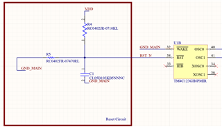

    I decided to check the values of R1, R2, R3 and R6 off board two.
    The values measured correctly,
    R1, 10k, 9.86k
    R2, 10k, 9.99k
    R3, 100, 99.2
    R6, 10k, 9.91k
    The custom board has a SMT header for pogo pins,
    I have wires soldered to these pads going to a 14 pin JTAG header.
    From the top.
    PAD 1 JTAG_TMS -> TI 14-PIN 1
    PAD 2 JTAG_TDI -> TI 14-PIN 3
    PAD 3 JTAG_VREF -> TI 14-PIN 5
    PAD 4 JTAG_TDO -> TI 14-PIN 7
    PAD 5 JTAG_TCK -> TI 14-PIN 11
    PAD 6 RST_N -> TI 14-PIN 2
    PAD 7 GND -> TI 14-PIN 8
    Here is a picture of the header going into the ribbon cable.
    Do you think there is a problem in the JTAG connection?
    Allan

    However when I try to connect to the MCU I get the same error message as before,
    My connection setup is as follows,
    I have eliminated a usb hub and thunderbolt docking station, but still get the unable to access the DAP error message.
    I have also tried connecting with the XDS100V2 and get a cable break error message.

  • Hi Charles,
    I also tried debugging the custom board with the uart_echo example just in case my project was corrupted.
    I still get the same unable to access the dap error message.
    The JTAG Scan test passes with the XDS110.

  • Hi Charles,
    I also tried another computer with the latest version of CCS 20.1.1.
    I am still getting the unable to access the dap error message.
    Allan
  • Hi Charles,
    I managed to find the problem. I accidentally had a resistor R5 that was not supposed to be populated pulling the reset pin low constantly. Removing this resistor fixed the problem.
    Thanks for you help.
    - Allan
