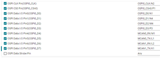

After that i took the flasher_jtag_uniflash_am263px-lp example, adapted the pinning in sysconfig and changed the flash settings ( just ID and size, if i changed other parameters it wont function anymore)
Then i took the Uniflashtool, chose the cosum flasher with the correct path to my adapted lasher_jtag_uniflash_am263px-lp example and flashed a adapted sbl_ospi and my application:

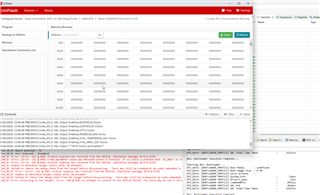

Here iam not quite sure what defines at which adress the external flash is located. I just took the adresses i used when i tested it at the am263p-cc eval board.

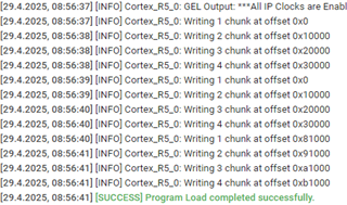

When i load the files uniflash says flashing was okay:
but when i try to read the memory at adress 0x60000000 there are just zeros. So nothing was written there.
Any ideas of what iam doing wrong?

    There are some changes that you need to make in the flash configuration in Sysconfig.
    To validate that the flash is working properly, we can use ospi_flash_io example in examples/drivers/ospi/ospi_flash_io.
    Before changing the flash configurations, run the diagnostics example on your flash and note down the SFDP table.
    Please follows the steps below,
    1. Open the ospi_flash_io example in the SDK (make sure that all the settings are intact, none of the configurations in sysconfig is changed). Additionally, you can make sure that it works on the launchpad.
    2. Open the Flash Drivers Section in Sysconfig. (Sysconfig > TI Drivers > Flash)
    3. Change the Flash Size in Flash > Basic Flash Configuration > Flash Size in Bytes as in the SFDP table
    4. Change Flash JEDEC manufacturer ID and JEDEC Device ID as in the SFDP table
    5. Change Flash Busy Timeout as in the SFDP table
    6. Other configurations can be left as it was before.
    Now run the example, If the success message comes in the console/serial terminal, then we are able to write and read into flash. By this method, flash read and write can be validated.
    [NOTE: While changing these configurations, these is a chance that the OSPI output pins would change automatically. Make sure that the pins are locked before reconfiguring and very again once done.]

  • but when i try to read the memory at adress 0x60000000 there are just zeros. So nothing was written there.
    How are you reading the memory?

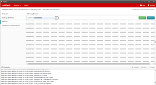

  • Iam using the Uniflashtool:
  • Hi Marcel,
    Seems like a issue with Uniflash tool,
    I have the SBL NULL flashed at 0x60000000 location and as you can see in COM port print. even then Uniflash is showing 0x0 at the location which is incorrect.
    Use flash read API to read flash content in application
  • I have flashed SBL OSPI and hello world and when I check from memory browser in CCS, I am able to see the correct content.

  • Your screenshot shows adress 0x0 and not 0x60000000
  • So you flashed with the Uniflash tool. How did you get to the memory browser? If you hit the debug another project you flash it aswell arent you?
  • Hi Marcel,
    Once you have flashed with the uniflasher tool, you can open code composer studio and launch a target configuration. Connect the core and then open the memory browser from the View option.
    You can follow this method to see the memory contents. There is no need to debug/flash another project.
    Aswin

  • Hey Aswin,
    ive just repeated the steps again.
    I took the flasher_jtag_uniflash_am263px-lp example, changed the OSPI pinning and the flash configuration like i did in the ospi_flash_io example.
    Then i powercycled my board and used the Uniflashtool to flash (costum flasher used):
    After that i launched my target config and opened the memory view and still the only thing i see are zeros:
    Can it be a problem with the adresses i use?
    Do you have any other ideas, what i can test?
    Marcel

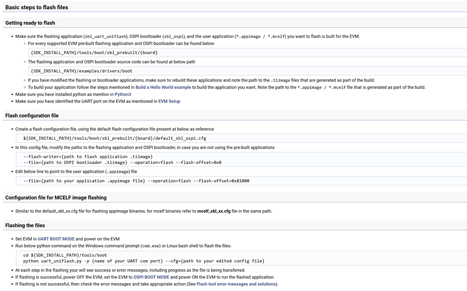

  • Hi Marcel,
    Can we use a different method to flash into the device to see if the problem persists.
    Can you use UART flasher method. You can find the steps to perform flashing via UART here.
    See the section Basic Steps to flash files under UART Uniflash. Be sure to use the updated flasher and SBL files.
    Aswin

    Please follow the steps to flash using custom flasher.
    1. The custom flasher image needs to be built by the user. For this, open the project mcu_plus_sdk_am263px_10_00_00_35/tools/flasher/jtag_uniflash project in code composer studio.
    2. After making the changes to flash configuration in sysconfig (if required) build the project. You will get an .out file. This .out file is the flasher file that you need to mention in the custom flasher option in uniflash. Make sure that the pin configurations and flash configurations are correct.
    3. Now check the Custom Flasher checkbox and mention the path and the file name of this .out file in uniflash. Please see the attached screensnip.
    I have mentioned the path and the file name of the .out file.
    4. Now load the SBL and Application. I have loaded the SBL after adapting the flash configuration to my flash device in sysconfig.
    5. The device should be flashed after pressing Load Images button.
    You can flash the device by keeping it in OSPI/DevBoot Mode. Also, it is recommended to use the latest version of uniflash.
