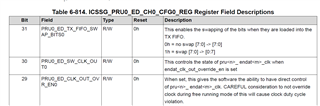

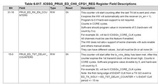

  • (1) You can try shifting the clock via ED_TST_DELAY_COUNTER0, 16-bit counter, allow delaying the clock start. Configured in ICSSG_CORE CLK units. But this may not help with clock/data timing adjustment.
    (2) Other option is to manually generate the clock using say a free PRU. Set ED_CLK_OUT_OVR_EN0 and directly control CLK pin using ED_SW_CLK_OUT0
