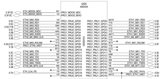

we are trying to establish an EtherCAT connection to a custom board with an AM2434 µC and two DP83822 PHYs (addresses 0 and 1). For testing purposes we are also running the software on the AM243 LaunchPad. Our software is based in on the TIDEP Dual Motor Drive example from the AM243 MotorControlSDK.
With the LaunchPad we are able to connect to the device over EtherCAT using the TwinCAT software on both Ethernet ports. For our own board we are only able to connect to TwinCAT with one of the two ports. Additionally, it only works with disabled Fast Link Detection.
For our board, the PHYs are configured as follows:
#define ECAT_PHYADDR_IN                     (1u)
#define ECAT_PHYADDR_OUT                    (0u)
#define ECAT_PHYPOLINVERT_IN                (true)
#define ECAT_PHYPOLINVERT_OUT               (true)
#define ECAT_PHYUSERXLINK_IN                (false)
#define ECAT_PHYUSERXLINK_OUT               (false)
A remark to the configuration: I had to swap the addresses of In and Out against my actual expectations of how they should be. Before the swap, I was not able to find the device on any of the ports. Additionally, the device is not found with ECAT_PHYUSERXLINK_IN/OUT (true). I also tried both PHYPOLINVERT settings. MDIO__REGS_LINK_REG is set to 1, as i connect the device, so it should be High active.

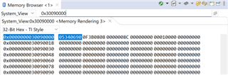

I also checked the EtherCAT status registers at offset 0x30090000 (device is connected in both cases, but without communication to TwinCAT):
    • Can you monitor 0x30090E00 and 0x30090E04 to make sure RX Frame counter is getting incremented so that we can confirm frames are being received by the TI ESC (Firmware). Details of the register can be found at TI EtherCAT SubDevice Controller Register List.

    just curious. How do you come to this address 0x0x30090000?

  • Hi Jinlong,
    PRU_ICSSG1_RAM_SLV_RAM space from 0x30090000 will have the ESC Registers emulated in the case of ICSSG1 instance and PRU_ICSSG0_RAM_SLV_RAM space from 0x30010000 in the case of ICSSG0 instance.
    To access the memory space from CCS, navigate to View > Memory Browser and give the address and choose System_View as shown below:
    This space can also be accessed from TwinCAT by navigating to Box1 > EtherCAT > Advanced Settings > ESC Access > Memory.

  • Hi Aaron,
    If the software is aligned identically for both the PHYs, could be an issue with Hardware configuration maybe. Make sure you have connected PRx_MII0_RXLINK and PRx_MII1_RXLINK and additionally, could you probe PRx_MII1_RXLINK pin and see if it is getting updated with the link status?
    I just probed MII1_RXLINK link on the PHY side. It is set to high, as soon as I connect the cable. So, as expected...
    It connects to PRG1_PRU1_GPO8 on the Sitara. The other PHY (port 0) is connected to PRG1_PRU0_GPO8. This is the pinout for connections between the PHYs and our Sitara:
