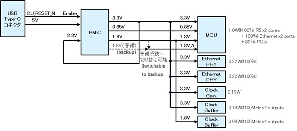

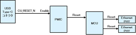

  • Hi Sreenivassa,
    Thank you for your response. I've received some feedbacks to your questions from the customer. Please check below.
    The Application note recommends to implement the attached device reset using a 3-input ANDing logic for GPIO, PORz_OUT and RESETSTATz signals, but the customer doesn’t use AND gate logic. Only GPIO of AM243x is used for Ethernet PHY Reset (release).
    Here is the block diagram of power rails.
    Power for AM243x and Ethernet PHY are supplied by PMIC from 5V.
    By turning off 5V for PMIC or making Enable Low, both Ethernet PHY and AM243x are turned off.
    Is there any problem on this customer’s design ?

  • Hello Hideaki
    Thank you.
    The block diagram does not include the PMIC OPN used.
    If the question is can you connect only SOC IO to the EPHY reset, you should be able to pulldown the EPHY reset.
    If there are any pin strap that are required to be latched, the recommendation is to release the EPHY reset before the SOC Ethernet interface peripheral is initialized.
