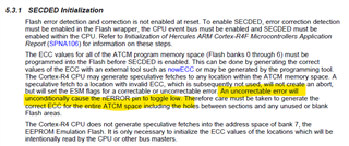

  • Hello Jagadish,
    Thank you. It looks like your statement "You can directly execute the code in bank-7…" contradicts the reference manual (SPNS192B –OCTOBER 2012–REVISED FEBRUARY 2015). It says, "(3) Code execution is not allowed from flash bank 7." See the snapshot below.
    Both flash and RAM will be protected by ECC and will correct single-bit errors and detect more than one-bit error and generate NMI (Group 3 error) and assert the nERROR pin. So are you saying the SECDED logic does not trigger NMI if there is more than one bit error? Please clarify these two items.
    Initially i thought the same (execution cannot happen from bank-7), but i gave a try and it worked for me. You can do it from RAM as well, i mean storing in flash and running from RAM this should also work without any issues.
    You are correct we can call ESM errors as NMI's, there is a control for Group-1 errors at ESM level that means we can configure whether they should trigger ESM interrupt or not.
    However, for Group2 there won't be any configuration to disable the interrupts, and they will always trigger the interrupts. And finally, for Group3 they will trigger aborts and there won't be any interrupt generations for group3 errors.
