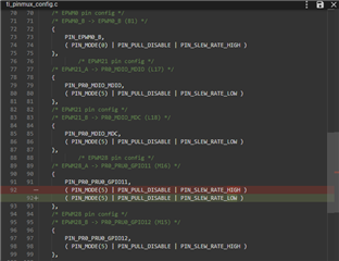

I then try to implement this in Code Composer Studio. In the "syscfg," I set up an instance of EPWM28 and select the pin that matches the documentation (M16). Checking the ti_pinmux_config.c file, I see that the auto generation correctly selects pin mode 5 to use it as a PWM pin.
Auto Generated Pin Mux Code:

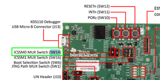

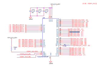

  • TICSC,
    There is a MUX upstream from the HSEC pin on the control card that controls the routing of the signal coming from AM263Px pin M16 to either the on-board Ethernet interface or to the HSEC pins:
    In order to route this signal to the HSEC connector, SEL1 of this mux needs to be pulled high. You can control this select signal using SW14. The default position of SW14 is LOW. Please try toggling SW14 to high and running your code again. You should now see the EPWM signal at the HSEC.
    Brennan

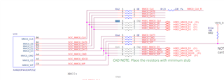

    I was able to get a PWM signal on PWM17 from probing the unpopulated pad of RA3 on the control card. It appears that this is directly connected to the AM263P chip and does not require a multiplexing chip. In order to route this to the HSEC, can I just short the pads of RA3 together? Could I also do this for similar PWM channels?
    TICSC
  • TICSC,
    Yes, you can short the pads on RA3 and RA5 to access signals from these pins at HSEC. I assume you are referring to these signals? You may want to remove RA2 and RA4 to avoid any stubs or signal reflections.
