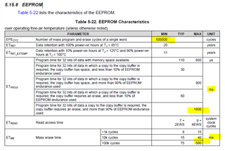

      First of all, please go over the EEprom characteristics on the amount of time it takes to program a word and erase a block. The programming time will depend if the copy buffer is required. It can take up to 1.8 seconds for the worst case. See below. For the erase timing, it depends how many times/cycles the EEprom has been subject to since fresh.
      How long have you been testing this particular chip before you see the 5-7 seconds of programming time? In another word, is this something you see when you start with a virgin chip or the problem is gradually starting to show up after extensive EEprom programming on the chip? You said you are trying to repeatedly program EEprom every 200ms. I don't know how long you have been playing with the device. Let's say you have subjected the device to programming EEprom every 200ms for a week. This can translate to three millions programming cycles. You may have exhausted the number of write/erase cycles.

    At first it was fast. After 3-4 days of continuous write at 200ms, we are seeing same behaviour as in Office board.
    Eval board : www.ti.com/.../MSP-EXP432E401Y
    As I mentioned in my prior replies, the device can age after repeatedly going through write-erase cycles. If you write every 200ms then in four days, you have subjected the EEprom to an estimated 1.728 million write cycles. Although the datasheet states minimum 500k of write cycles, the EEprom can greatly age due to repeatedly write operations.
