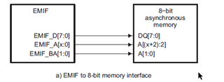

    If you are interfacing 8-bit asynchronous memory, then the least significant address lines (A0 and A1) of the external memory will be connected to Byte Address lines (BA0 and BA1) like as shown below:
    So that means the max address line A21 of the controller will be connected with A23 of the external memory that means the total addressable memory range will now become 2^24  * 8bits, which is nothing but 16MB.

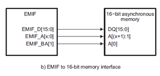

    Similarly, if we connect 16-bit memory with the device:
    then the least significant address lines (A0) of the external memory will be connected to Byte Address lines (BA1) like as shown below:
    So that means the max address line A21 of the controller will be connected with A22 of the external memory that means the total addressable memory range will now become 2^23 * 16bits, which is nothing but 16MB.
