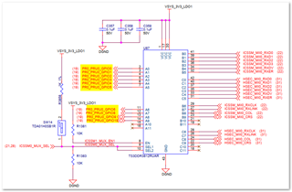

Regarding document https://www.ti.com/lit/an/spradp0/spradp0.pdf (Enabling Trace on AM26x Devices with Lauterbach®), it says:
"put SW-14 switch to OFF, SW-15 switch to OFF and SW-16 switch to ON state."
I can see why SW-16 is necessary to be ON this maps TRC_DATA0-15 to the HSEC, but I cannot see why SW-14 and SW-15 needs to be OFF. I need them ON for our application.
For example, SW-14 maps the following pins:
As far as I can see, PR0_PRU0_GPIO0-6 and PR0_PRU0_GPIO8-10 are not relevant to TPI.
Why is SW14 and SW15 relevant to Trace please?

    This document may be referring to an older revision of the AM263Px control card, and was not updated for the latest revision.
    Can you confirm you are using Revision A of the TMDSCNCD263P?
    If using Rev A, SW16 should be ON to map the TRACE signals to the HSEC. SW14 does not need a specific configuration. SW15 is irrelevant to the HSEC Mux routing.
    Please try with this configuration and let me know if you experience any additional issues. Also, please submit document feedback so the document can be updated:
    Not sure how I can identify Rev A but mine says PCB#: PROC159E2 and E156972 41/23 06-004 and SL#4223159004.

  • Not sure how I can identify Rev A but mine says PCB#: PROC159E2 and E156972 41/23 06-004 and SL#4223159004.
    Understood - this is E2 revision. The switch scheme is the same as Revision A, so my previous statement applies.
