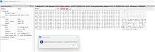

  • Hi Timo,
    I just tried in my side, no issue here:
    Thanks!
    Best Regards
    Johnson
