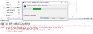

    We provide a method to force MCU reset and not run IWDT manually:
    Wait_for_debug DSSM scripts, after run this scripts manually, CCS can force MCU at high reset level and then load the firmware to device is not expected to be broken:

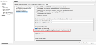

    We also provide a automatically steps in the project property:
    This auto step is little weaker than the manually process one, but it also worthy a try. If it doesn't work, I can file a request to do some upgrade in futher release, you can use the manual step for recently debug.

    If the device is "locked" by IWDT and I start the Wait_for_debug DSSM script, I get the error "Unable to access device register. Reset the device, and retry the operation. If error persists, confirm configuration, power-cycle the board, and/or try more reliable JTAG settings (e.g. lower TCLK). (Emulation package 20.0.0.3178)"

    Enable the function wait for debug in Project properties doesn't help either. I still get various error messages. Also starting MCU in BSL mode with PA18.

    Additional information is that, make sure your IWDT is working currently.
    If you are not feed IWDT in the firmware, then you will find that IWDT trigger POR, POR occurs will destroy all the SWD conncection, and also clear the message in the DSSM mailbox. So the scripts will not work. Or you can say IWDT locked the device.
    If IWDT locked the device (IWDT trigger POR periodically), then the remaining method is that, connect the PA18 to VCC, then re-power on or pull down NRST more than 1s. After POR reset, the device will reset IWDT by POR, and then enter BSL mode which will be connected correctly.
