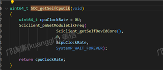

Hi TI Experts,

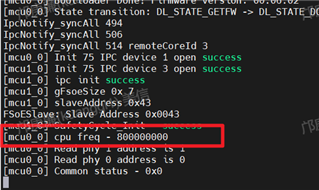

Customer has two different speed grade chips with S & K respectively shown below. It is theoretically expected that the R5FSS Max frequency should be 800M with S, and only 400M with K.
However, after customer applied the below function to read the frequency, they found the R5FSS Max frequency is 800M for both S & K shown below.
Customer wants to know why this happens?
