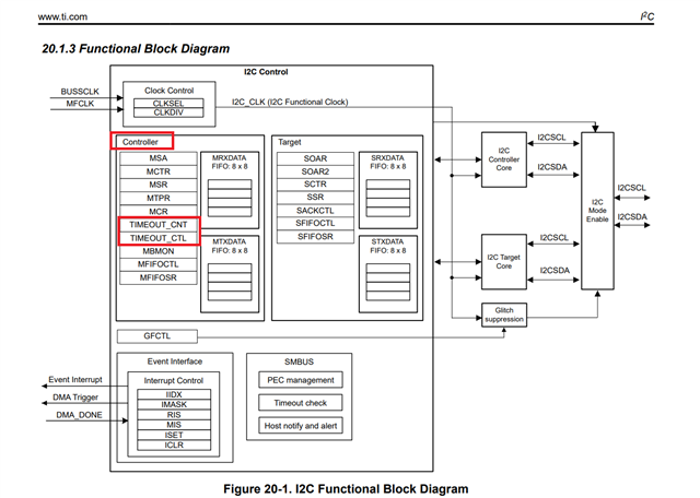

    1. TIMEOUTA can only be used in I2C controller, but cannot be used in I2C target mode. Is it right?
    2. Because TIMEOUTA can be used to detect SCL is low for a timeout time, can the user just use it (enable both I2C control and I2C target modes) to detect SCL low using TIMEOUTA interrupt for a timeout time directly as the Method 3 besides (Method 1 and Method 2 you showed above)? Or is there any concern?
  • 1. TIMEOUTA can only be used in I2C controller, but cannot be used in I2C target mode. Is it right?
    20.2.3.6 SCL Clock Low Timeout, there are description for this function here.
    Based on the question answer in 20.2.3.6, TIMEOUA is a function of I2C target.

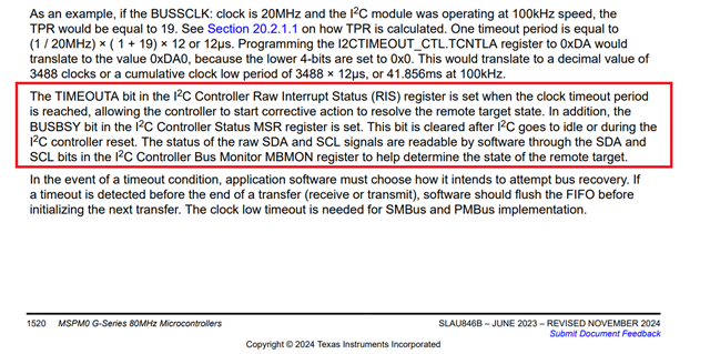

    In fact, we've read 20.2.3.6 SCL Clock Low Timeout but are still confused if it's used in Target mode or Controller mode.
    From below in TRM, it seems to imply it's used in Controller mode implicitly.
    Would you please help confirm again?
    Or it can be used in either Controller or Target Mode?
  • In fact, we've read 20.2.3.6 SCL Clock Low Timeout but are still confused if it's used in Target mode or Controller mode.
    It can be used in both T and C mode.

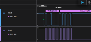

    Test demo for target timeout
    i2c_target_Timeout_G3507.zip
    Disable auto ACK for data,
    I2C_INST->SLAVE.SACKCTL = 0x00000003;
    Then Target will give a long time clock stretch, then Timeout A will be triggered.
    There is a BKPT in interrupt, you will hit this breakpoint in debug.
  • Hi Helic,
    Thank you for your support.
    Besides, we found the errata did matter. After disabling it, we find it works as expected.
