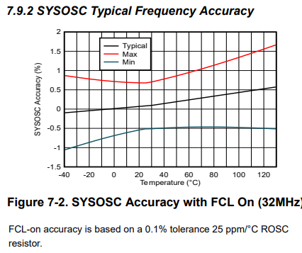

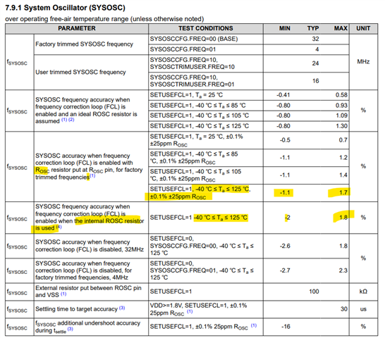

  • Do you confirm that this is the best configuration possible to maximize the accuracy ?
    Accuracy is mainly based on SYSOSC.
    You can enable SYSOSC's FCL function with external Rosc.
    For the FCL accuracy, please refer to datasheet - 7.9.1 System Oscillator (SYSOSC) - SYSOSC accuracy when frequency correction loop (FCL) is enabled with ROSC resistor put at ROSC pin, for factory trimmed frequencies
    2) I struggle to understand how to determine the accuracy at the output out of the PLL, can you elaborate ?
    The time accuracy is mainly based on SYSOSC's accuracy.
    Yes I saw these information, which are coherent.
    To be more specific, I need a total accuracy < +/-2% over the entire temp range -40 to 125°C.
    1) Using the external ROSC seems to give enough margin
    2) Using the internal ROSC could be an option too but there is no margin. You said that the accuracy mainly depends on the SYSOSC but in this case I still need to understand how the PLL will affect the accuracy to determine if option 2 is viable. Does the PLL increase the inaccuracy to +/-0.1% ? Less than that ?
