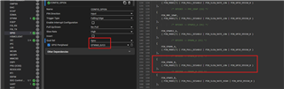

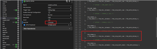

SYSCONFIG: AM263P4 sysconfig GPIO "Qual Sel" option seems to not work
Part Number: SYSCONFIG
Using SysConfig 1.23.0+4000
How do you change the "Qual Sel" option on sysconfig?
Before:
After:
I was expecting the tool to add PIN_QUAL_XXX flags to ti_pinmux_config.c::gPinMuxMainDomainCfg[].   But nothing changes regardless of what value I choose for "Qual Sel".
Please help me understand what I am doing wrong here.
