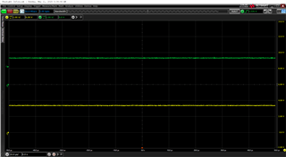

EK-TM4C123GXL: Can't see I2C signals using example code
Part Number: EK-TM4C123GXL
I am having trouble seeing the I2C SDA and SCL signals on my EK-TM4C123GXL Launchpad using example code.
I have pins PB2 on CH1 and PB3 on CH2.
Both PB2 and PB3 are connected to 1.5k pull up resistors.
Below is the code I am using,

Both CH1 and CH2 both stay at 3.3V constantly even when sending "I2C" constantly.
Allan
  • So I accidentally used 1.5 ohm resistors as pull ups instead of 1.5k resistors.
    I replaced the resistors with 1.5k and replaced the microcontroller.
    Also commenting out the slave module fixed the problem.
